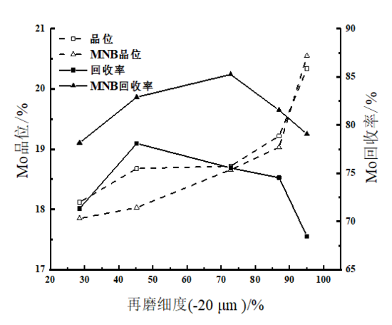

图1 再磨细度试验结果
Fig. 1 Results of regrinding fineness test

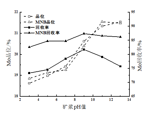

图2 矿浆pH值试验结果
Fig. 2 Results of pulp pH value test

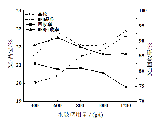

图3 水玻璃用量试验结果
Fig. 3 Results of sodium silicate dosage

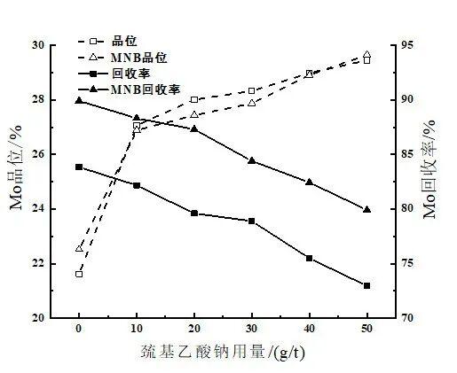

图4 巯基乙酸钠用量试验结果
Fig. 4 Results of sodium thioglycolate dosage

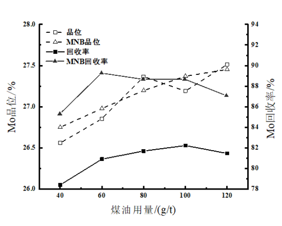

图5 煤油用量试验结果
Fig. 5 Results of kerosene dosage

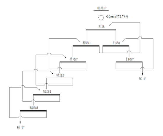

图6 闭路试验流程
Fig. 6 Flow chart of closed circuit test

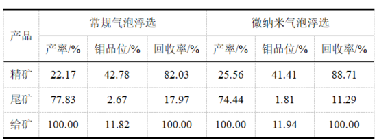

表1 闭路试验结果
Table 1 Results of flotation closed circuit test

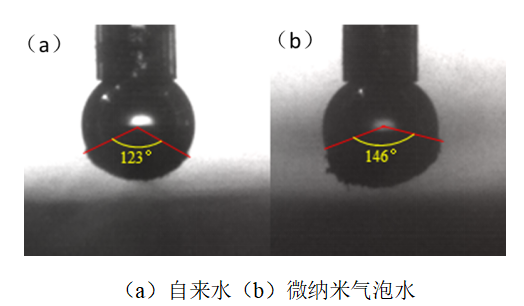

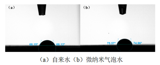

图7 不同溶液体系下的辉钼矿颗粒接触角
Fig. 7 Contact angle of pyromorphite particles in different solution systems

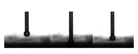

图8 气泡与矿物颗粒床层动态接触过程
Fig. 8 Dynamic contact process between the bubbles and the bed of mineral particles

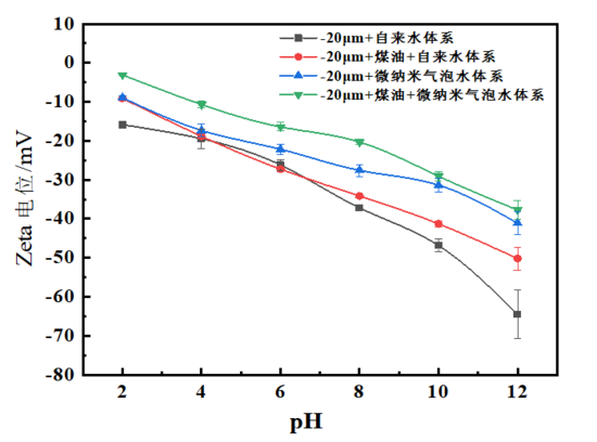

图10 微纳米气泡对煤油作用前后辉钼矿Zeta电位的影响
Fig. 10 Effect of micro-nano bubbles on Zeta potential of pyromorphite before and after paraffin action
